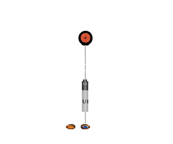

Instead of explaining more verbally, I've created some illustrations to show this point. I so far couldn't find such illustrations from proper scientific resources, so had to create my own, hence.. Disclaimer: I'm sure this is only part of the picture and the actual physics may not be accurate. Those with better knowledge should plz augment.
With one (dominant) eye open, there is perception of only one image. In most cases this is the ideal situation for targetting, if not for sustaining it long enough etc as previously discussed in detail by Gilani sahab

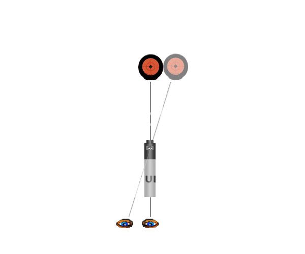

With the non-dominant eye also open
and focussed on the front sight, because of the axial displacement from the dominant eye, it percieves its own image of the target. It is the less dominant image as well, you see it less clearly, more opaque
This error simply magnifies the greater the distance to the target, as illustrated below. That is why i didn't notice this while dry practicing because of never more than 8-10 M distance there
To prove the double image phenomenon isn't an aft mechanism only, now just experimentally try to focus on the target. As soon as both eyes index completely on the target, theres a double image of the gun/muzzle.
In all of this, as soon as you close one eye, the double image vanishes. Now TRUE, that in my case:
1- When focussing on the front sight, when i close the right eye, the right image disappears and vice versa
2- When focussing on the target, the exact opposite is the case, ie on closing right eye, left image of gun disappears and vice versa
This also indicates that the above illustrations need to be augmented by the actual physics of the human visual system. But i truly hope that this info helps other shooters who may face this problem

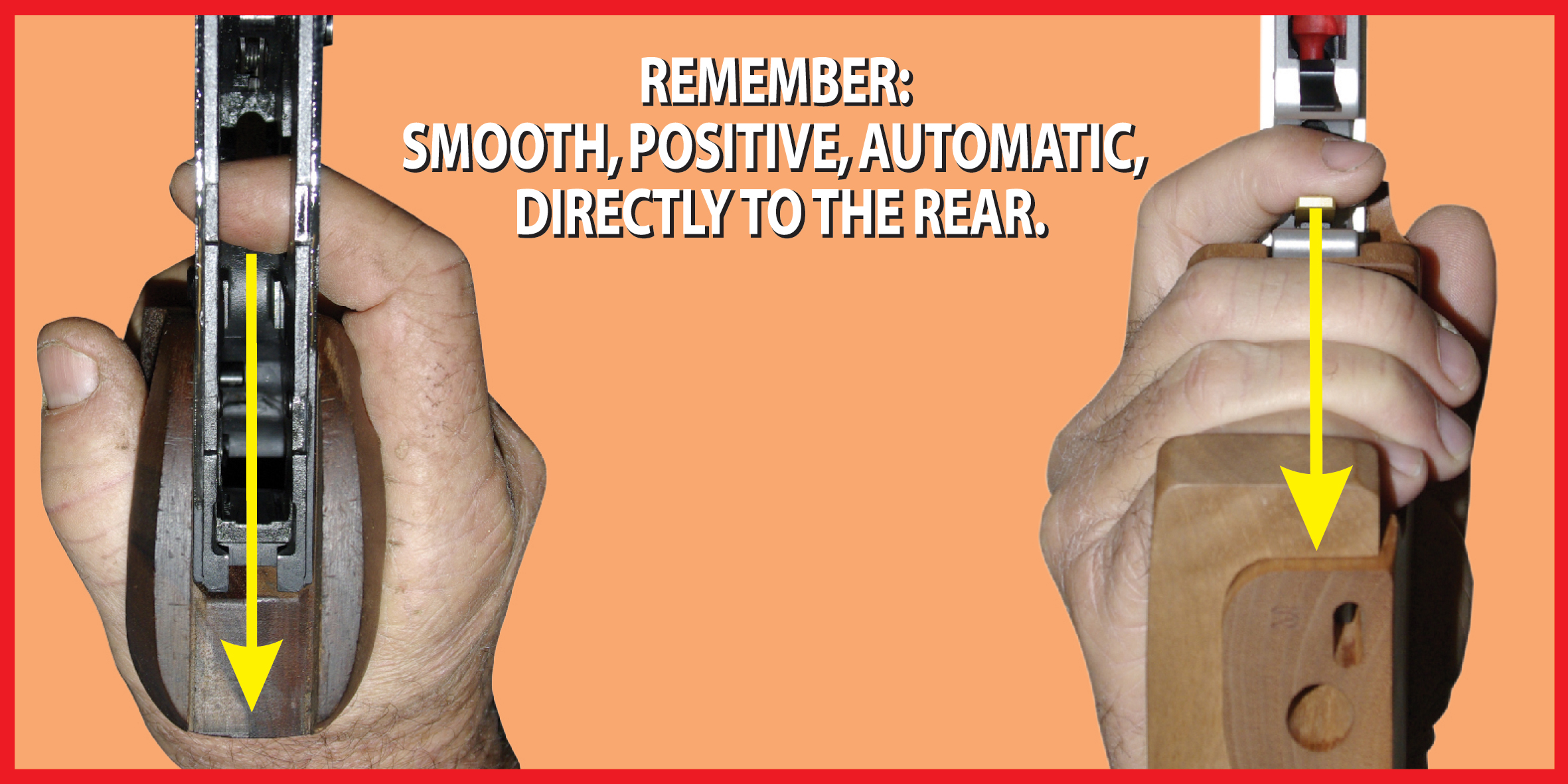

1) Trigger finger placement: You should never have the front surface of your pistol's trigger any deeper along your trigger finger than the crease of the index finger's first knuckle. Better still is to place only the very tip of your trigger finger against the front surface of the trigger.
In the illustration above, proper trigger finger placement would be between the first crease (labelled "bent finger") and the end of the shading in that first finger segment. As long as the shooter can get sufficient muscle power, the optimal trigger placement would be on the finger tip at the end of the shading.
2) Direction of effort: As you begin your trigger press sequence, the musular effort should be directed into the trigger face parallel to the centerline of the pistol's bore. Straight back and only straight back.
3) Quality and quantity of effort: Remember, all you want to do is deliver sufficient energy into your trigger so that the spring pressure energy of the pistol's hammer is transferred to the firing pin. The delivery of that energy should be done as smoothly as you can possibly muster, and the pressure that you apply to the trigger's face should be very, very gradual.
One way to practice this is to take the tip of your trigger finger between the index finger and thumb of their other hand. Slowly squeeze the trigger finger tip such that you can barely feel the increase of pressure. Doing so helps to illustrate, in a tactile way, the quality and quantity of pressure needed to achieve a successful trigger press.

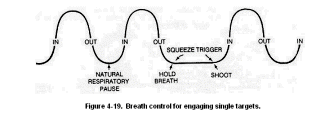

ON BREATHING CONTROL
Courtesy: http://westernrifleshooters.blogspot.com
As suggested by the illustration above, one of the key parts of firing a good deliberate shot, especially at intermediate and long range, is breaking it during the pause between inhalation and exhalation.
At most, you have around five seconds (+/- 2) during that trough where your sight picture (and hence your shot) will not be affected by your body's movements as you breathe. If you have been exerting yourself, that 4 to 6 second pause becomes maybe 2 or 4 seconds before your brain says, "Time to inhale!"
To make the most of that short period, here are a few tips:
1) If you can, take a few deep breaths before you settle into position for that shot. More breathing means more oxygen in your blood, and that means more time for your respiratory pause.
2) If you find yourself running out of breath, STOP! Your tendency will be to rush your shot, and your accuracy will suffer. Instead, take a deep breath or two, put your sights back on the target, and create a new respiratory pause so that you can make that shot count.
3) If you have really been exerting yourself (say, for example, by running for your life), you may want to use Dave Grossman's autogenic breathing technique:
...The breathing technique that is being taught to SWAT teams, police departments, Green Beret battalions, and other elite forces around the world (sometimes referred to as “autogenic breathing”) consists simply of a deep, belly breath: breath in for a four-count,hold for a four-count, breath out for a four-count, hold for a four-count, and repeat three times.
This technique will both calm you and replenish your bloodstream with sufficient oxygen so as to make a steady shot more possible.
4) Your dry-fire practice will pay dividends here as well. The more practiced you are at assuming a firing position, establishing your sight picture, and firing an accurate dry-fire shot, the better you will be at the range or in the field. We will discuss dry-fire practice more in detail below.
The above is clear about which part of the finger to place on the trigger. But where on the trigger should I place my finger. The middle part of the trigger or the lower end of the trigger?
