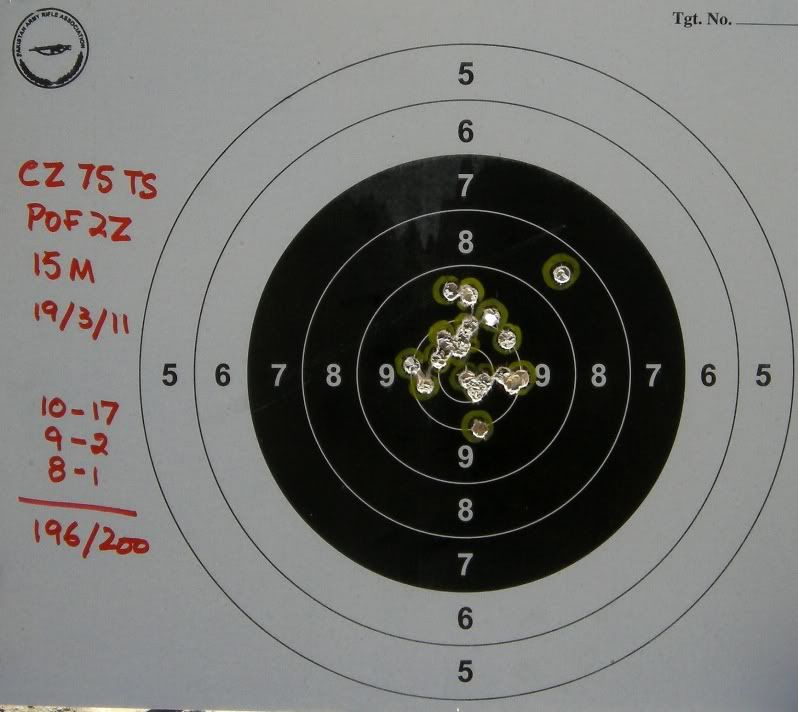

I will try to illustrate this point by showing some targets ..........
Now here is a group of five shots fired from 20 M. Though the score achieved is 45/50 which is quite good but each bullet is hitting at least 1" away from the nearest bullet and the overall groups size is 3.7 inches. So I would rate it NOT SO GOOD SHOOTING, though the shooter was able to get 45 out of 50 points.
Here is a second group of five shots fired from same distance and same handgun. The score here is 35/50 which is NOT A GOOD score. However, if you observe the shot pattern analytically you would realise that the shooter shot three bullets in less than one inch which is excellent. Fourth bullet is just an inch away. Fifth bullet (which incidentally gets him the maximum points) is quite far off and is actually an error on part of the shooter, a flier as we call it. THIS IS MUCH BETTER SHOOTING than the previous target. Now, if you just shift the MPI of the four bullets in the bull, this shooter would get around 48/50.
Someone may ask that the purpose in the competition is to get maximum scores. The guy in first target got scored more points so his is better. Not in my view. I feel that the second guy would be able to shoot better scores more consistently as compared to the first guy, after his gun is properly zeroed because he is capable of shooting smaller groups. The scores will automatically follow and he will finally be able to shoot something like this............
An since the second guy can make small groups consistently, he would be able to shoot something like this when needed.......
(PS: All targets have been shot by me and i have used them here just to illustrate the point)
