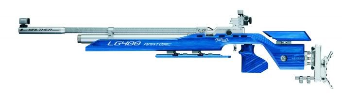

Walther LG400 Anatomic EXPERT
Specifications
System Compressed air 300 and 200 bar
Caliber 4.5 mm (.177) pellet
Cylinder Aluminum cylinder with pressure gauge
Capacity 600 shots / cylinder
Maximum energy 7.5 Joules
Stock Stock carrier laminated wood
Stock length (mm) 290-370
Grip MEMORY 3D-grip, right M
Trigger Two-stage and dry-firing trigger
Trigger weight (g) 50-120
Sights INSIGHT-OUT Competition sight and Centra foresight
Sight length (mm) 650-850
Barrel Barrel jacket Carbon
Barrel length (mm) 420
Dimensions (L/H/W mm) 1075-1100/280/50
Weight (g) 4100
Packaging Plastic case
Go for gold with WALTHER guns.
Successful sportsmen choose WALTHER. They have garnered gold medals and titles with air guns of the LG300XT Series. How can this string of victories be continued in the future? The reply of WALTHER‘s engineers: with the LG400.
Your personal high-tech precision rifle.
The WALTHER development center has created a high-tech precision rifle that‘s ahead of its time: pointing the way forward with its functionality and with its wide range of features. Assemble for yourself an air rifle matching your requirements in full, and start to prepare for your competition. With the LG400 you‘re a winner – as a club member or as an Olympic participant.
LG400 Anatomic EXPERT:
■ Compressed air system for 300 and 200 bar
■ Modular system for personal features and upgrades.
■ Individually adjustable center of gravity and weight distribution
■ EQUALIZER magnetic absorber system
■ Pressure reducer with QUICKCLEAN air filter
■ Aluminium cylinder with pressure gauge
■ Ergonomically shaped loading lever can be placed on the left-hand or right-hand side
■ Carbon fiber barrel jacket
■ ECO valve technology:
- Minimal opening pulse
- Reduced shot development time
■ Breech: convenient loading, precise pellet guidance
■ Loading status indicator
■ Dry firing trigger
■ VARIO trigger for extremely fine settings
■ Laminated wood stock with a wide range of settings and T-slot rail
■ Precision stock length and cheek piece setting
■ 3D grip adjustment with MEMORY effect
■ Infinitely adjustable fore-end with knee joint
■ Light metal butt plate MEC CONTACT III
■ Absolutely tension-free barrel mounting
■ INSIGHT-OUT match diopter, CENTRA SCORE foresight holder
■ CENTRA height and laterally adjustable sight elevation
■ Barrel weight, fore-end weights, butt plate weights with rod
■ Gun Case and accessories
Source: Carl Walther GmBH
http://www.carl-walther.de/index.php?co ... oduct=1640
