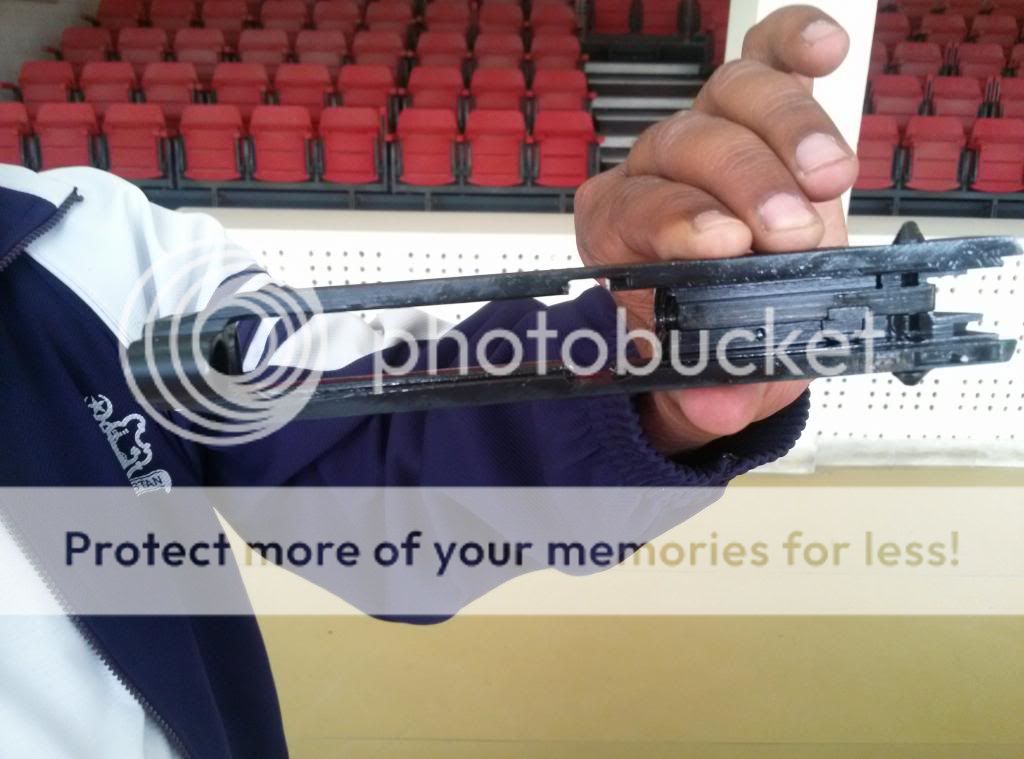

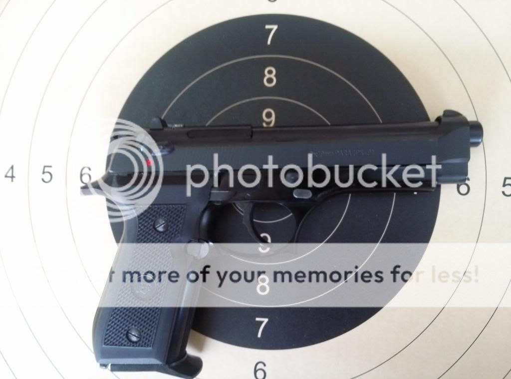

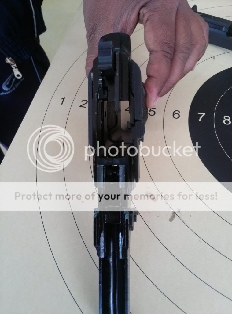

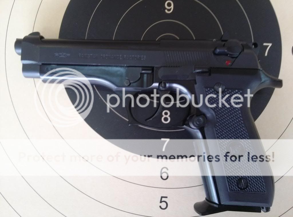

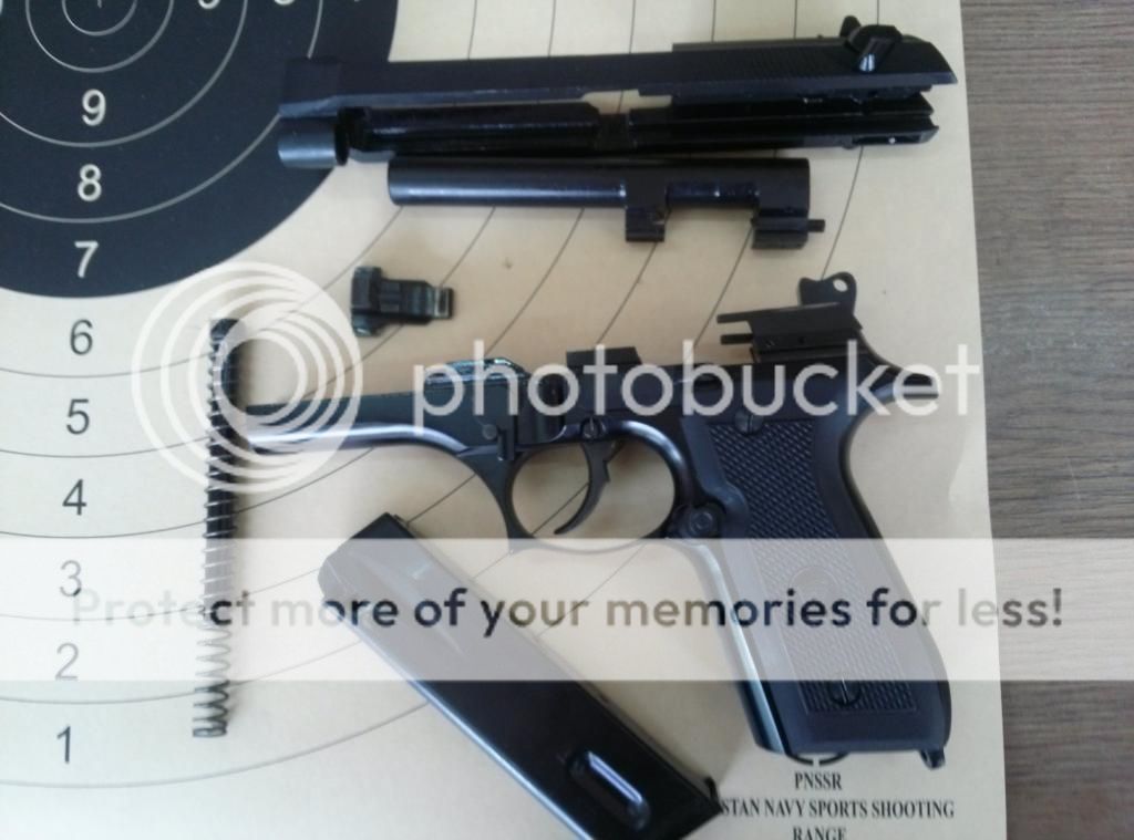

:arrow: Gun comes packed in a plastic box. Its quality is so so but better than a cardboard box or older model CZ boxes. It comes with two mags and a user manual only.
:arrow: Exterior finish looks OK but it can get scratched easily. Grip plastic panels look and feel no better than any Darra made clone. Interior fit and finish is horrible.Tooling marks and rough edges are everywhere. I have handled many Darra made clones and I can safely say that its no better than a medium quality Darra made gun. In comparison with a Royal Arms Beretta clone, this looks quite inferior. Tilted locking piece ( I think its the small metal part which fits between slide and barrel ) seems flimsy. It doesn't weigh as much I expect it should and in my humble guesstimate, its not very durable. YMMV . Barrel finish leaves lot to be desired as its finish started to wear off pretty quickly.
:arrow: Trigger has a long pre travel but its relatively creep free. Seems to be in 5.5 Lbs range. Reset is long. Grip feel is little awkward to me but other shooters at range did not share my views. Felt recoil is quite manageable.
:arrow: I could no get good groups even from 10m, both hand hold. Another shooter tried 5 rounds with similar scattered group. May be a better shooter can give a verdict on its accuracy.
BTW this is what I managed from 15m, single hand with a different gun.
:arrow: Reliability was poor. Suffered 3 failure to eject with Norinco and POF 1Z ammo. It seemed to be an ejector issue as all three cases were still partially in chamber and had to be manually pulled out.
Conclusion
IMHO it is no better gun than a Darra made clone. It was expected that POF, with all the resources at its disposal, will produce a better product. Even the barrel seems to be of the Darra made quality but an expert will be able to tell us for sure. If I had to choose a local gun because of budget constraints then I would be happier with a Royal Arms Company Clone with its life time warranty and more confidence inspiring fit, finish and feel.
