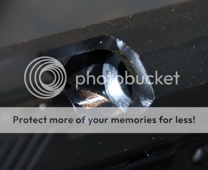

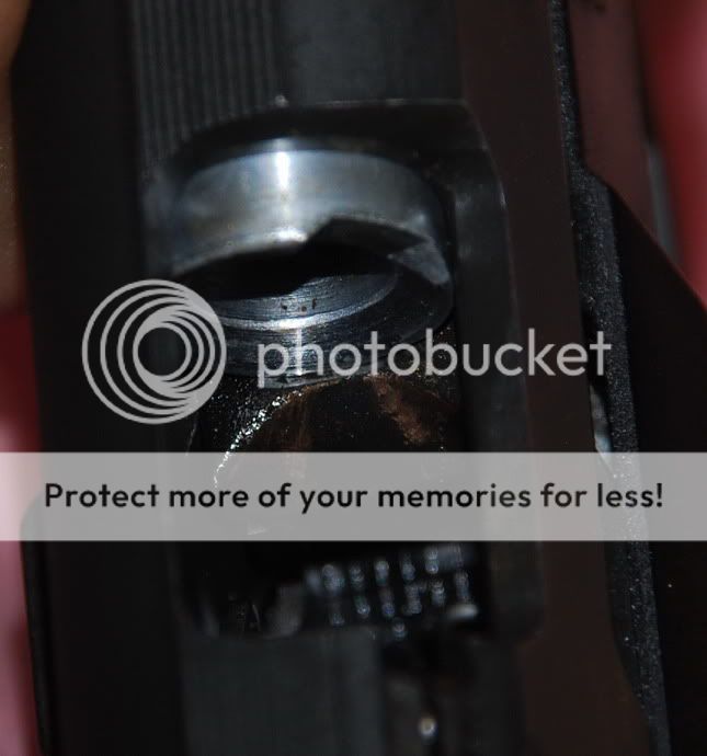

Further, can you please post pictures of CF98 feed-ramp with with slide locked back, and a loaded mag inserted, at a few different angles. I might need to see a few things.
 Post subject: Re: Norinco CF98 / NP42 Malfunction
Action & Barrel
Based on above pics, the second bullet would get stuck between the feed ramp and the casing of the chambered bullet instead of acting as a firing pin. Seems like a negligent discharge.
