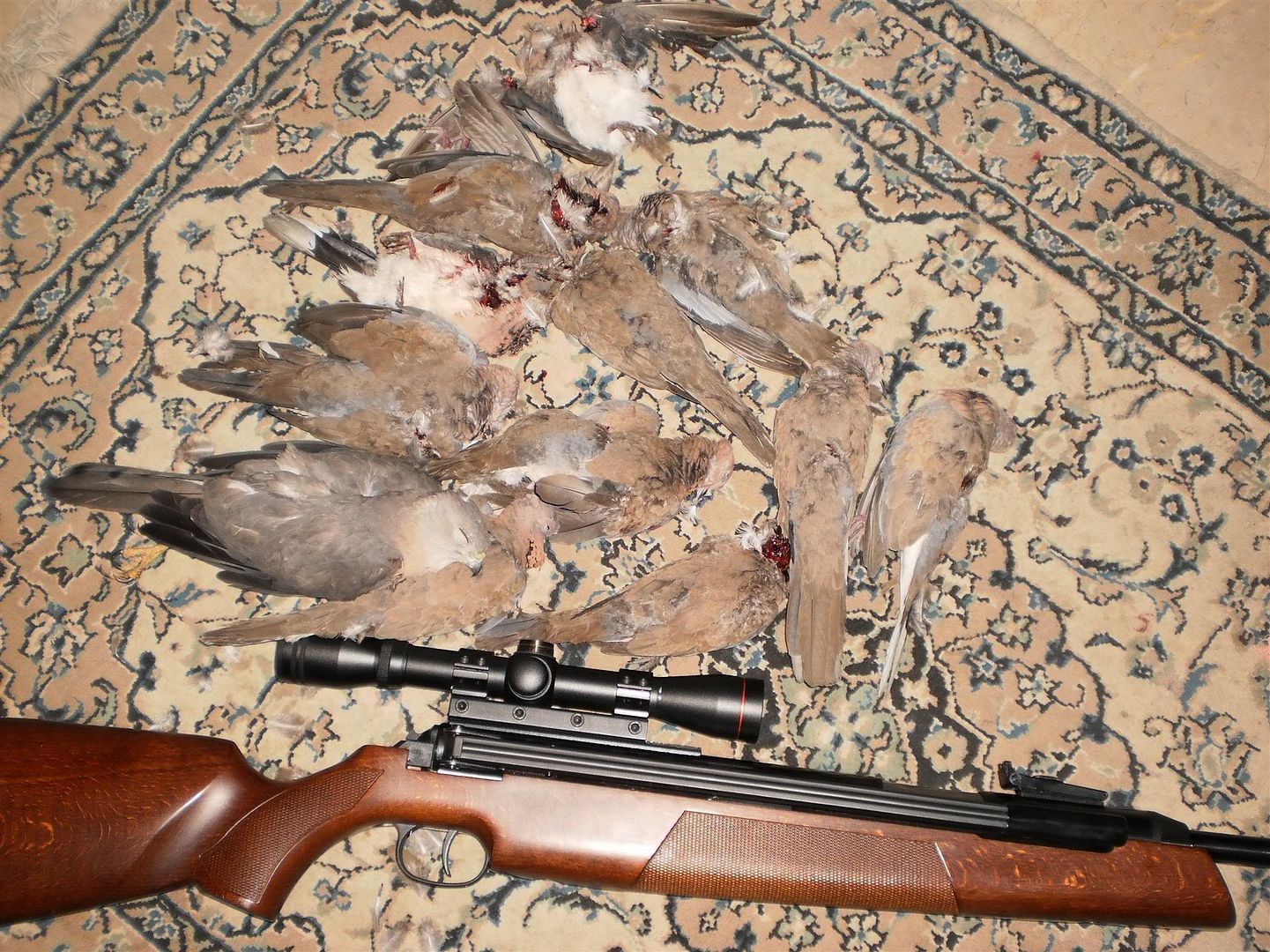

beware folks
u need a very good grip and control with air king, as this is a heavy rifle and for most of hunters, it would be a great disappointment in the start...that includes me.As I try to aim at the target,,,the barell swings and I instinctly know that the chances of a kill are scarce... and after a week of very average hunting sprees, I had been reduced to target practice and doing a lot of pushups to pump some extra strength into my arms.
having bought a genuine diana scope and a genuine diana full body mount,,,I seem to have regained my gun,s fitness for scoped shooting to a great extent. I am now able to shoot upto 50 yards with convenience and ,ve regained my shooting confidence.

 Post subject: Re: RWS DIANA 54 AIR KING > Review & Range Report
Scope and mount look great. How is the weight of the gun now ?
@fluffmaster everything seems ok. But please note its breeding season, please do not hunt anymore doves. And do I see a "Shikra" (grey color) next to the scope?
no offence,,,but my neighbour has been complaining of these local falcons as hunting his pet pigeons,,,3 or 4 lost in the past week...so I had elimination of pests in mind when I shot it
the facts of dove,s breeding season are quite a controversial issue and in my effort to arrive at the facts ,,,I collected extracts from at least a dozen resources from the internet,,,which are listed below. There still is another question and that is how much of breeding season hunting has been discouraged in Islam.Whereas I agree that it is undesirable to hunt during a species breeding season,,,I must also observe that birds that are strong breeders ,,,may be an exception to this. Any ways I think the discussion , if supported by authentic analogy and reasoning, may be a good precedent to follow
