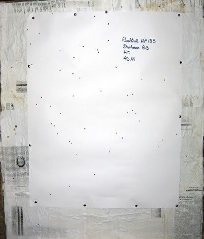

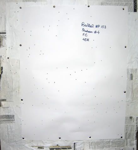

@haider

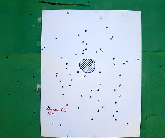

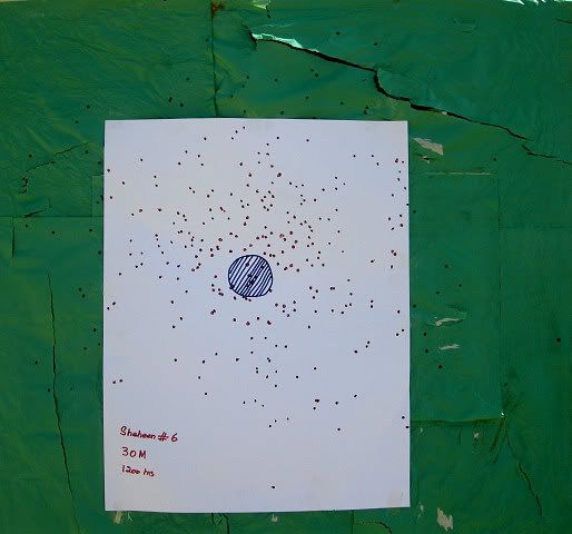

How do you compare these patterns with the ones formed by your gun. This is from 45 M with full choke, using Shaheen #4 and BB

Actually, the gun had a fitting issue, i got it tailored thru Haji Akram .... it started coming on beautifully, took it out for doves/pigeons, excellent result achieved within short range, all birds beyond 30 yards were missed or snicked, so i went to a book store and bought few white charts, placed a circle in middle of the chart for as a bulls-eye, checked the pattern from 15-20-30-35 yards with same shaheen #4 with full choke, pattern was amazing till 25, noticed a bit bigger pattern at 30 yards but when fired at 35, hardly 30% of the pattern was on the chart equally distributed.(By 30 % i mean u can actually count the number of slugs) This bugged me because the bulls-eye was around a 2 inch thick cirlce and the pattern had zero slugs near/around the bulls-eye..
It was disappointing because all game birds equivalent to partridge or dove will be missed or injured at 35 yards. I cant tell the point of aim in the above 2 pics of urs but if u notice, there is reasonable width between the layout of slugs on the chart. If u turn the first pic clockwise and put a bird inside, it will be either winged or a miss but ur shot was taken at 45 yards where as mine is forming almost the same pattern but at 35 yards which is really disappointing...
Should i try and change the choke with another baikal, retest or what? pls advice as the gun i bought was brand new but im not satisfied with the results at all.

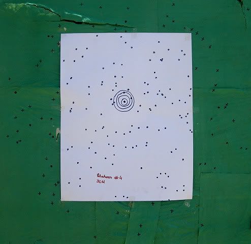

Just for the comparison sake, here is the pattern formed by my Baikal IZH 27 from 30 M, but using IC choke (4). With a F choke, it made a much denser pattern from 30 M.
During recent hunts, I missed a few easy shots with MP153 which I thought I shouldn't have. I was using Shaheen #6 with modified choke (3) at 30-35 M. However, when I shot with Eley #6 36grams, there was no miss at all, even at the distant flying shots.
Could it be the ammo??
I will have both IZH 27, MP153 along with a Browning Citori, Acer and Akkar Churchill shot from 30-45 M and see the pattern with both Shaheen, Eley and Cyprus shotshells.

@ KWB, bro if u notice your first pic, u got one slug on the bull where as rest are in 1 inch surroundings means that u will be able to drop a medium sized bird at 30 yards, where as mine has a width of at least 3-4 inches at 35 yards using a #4 with F choke...
