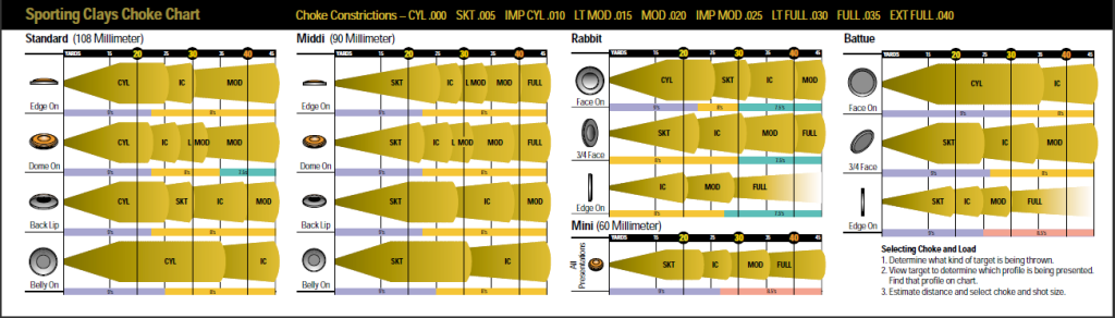

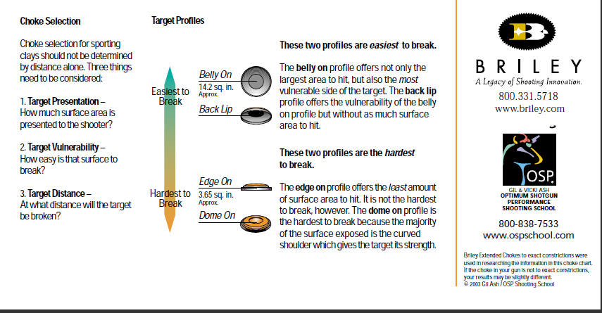

LAGS wrote:
But as far as names on the chokes like Sporting Clays, is there a Standard that you are required to use in sporting Clays competition, to make everybody equil, or limit the bore to certian constrictions?
As far as I’m aware there are no hard requirements that may call for the use of specific choke type or specific constriction by competitors across the board at a given event. Heck, one could even use a Full for every presentation (crazy idea though :mrgreen: ) if that works for that individual!
There is, however, the rule where one is not permitted to use two different gauges in the same shotgun at the same time. For example, this could be from a perspective of using a 12ga shotgun with set of sub gauge tubes – perhaps such as a 20ga in the top and a 28ga in the bottom barrel etc.
As an afterthought, here's an informal glimpse at a Sporting Clay Choke Chart. Note the constrictions are all standard. The target size(s) could vary. It would be imperative to keep in view that the following may not be used as a reference for “one size fit all scenarios” due to the factor of variables involved.

Sir, I have no knowledge about sporting clays, but the pics you have shared must be very useful for newbies getting into this sport!
Excellent Share! :D

@ AA: Sir, I have no knowledge about sporting clays, but the pics you have shared must be very useful for newbies getting into this sport! Excellent Share! :D
Not sure if there may be a direct benefit just by looking at that attachment :) ......I merely put that up more as a response to LAGS' query - since that visual indicates the suggested choke constrictions (as one may note, those are also standard choke specs) even in the scenario of Sporting Clays.

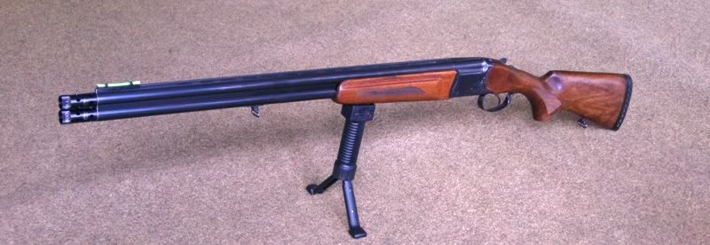

@hunter468
Do you have something like this in your mind??
IMHO, if you are looking at enhancing the performance of the gun by installing extended chokes of good quality than it would be worth the effort. However, if the purpose is to just enhance the beauty of the gun and the original factory chokes are patterning as per your satisfaction than I am not sure whether putting in extended chokes is the right solution!! It's going to cost you anything between 150-200 $ (including shipment and duty). In much lesser money you can get your gun stock redone through a good gunsmith and that would enhance the beauty of the gun much more than extended chokes, in my view. :)

@hunter468
absolutely not
the fact is that i have bought the gun (actually deposited the money before import),but it is at the dealer`s rack until i get my new licence in approx 12 days.i am not interested in ported chokes as my gun already has enough porting to knock the muzzle flip etc etc.i am looking not only for the beauty but for the better performance too
i am interested in golden or standard sporting clay choke tubes.what do u say about them???
