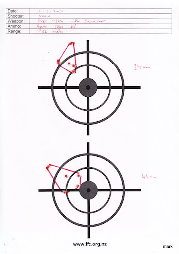

Aguila 38gn CPHP
I believe this ammunition to be from a brick of 500 High Velocity Aguila SuperExtra. I'm sorry I no longer have the original packaging to show you.
The accuracy is not as good as any CCI type tested, or as accurate as Winchester subsonics, but beats out everything else tested.
I would buy this again if CCI is not available when I need ammo urgently.
A brick of 500 Aguila is approximately NZ$60. Sorry I cannot find an exact price.

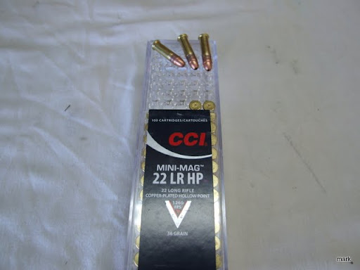

CCI Mini-Mag 36gn 1260fps CPHP
I have tried this for the first time, through my GSG1911 and Ruger 10/22, after being impressed with the accuracy of CCI Subsonic in previous range visits. Very similar group size to CCI Subsonics, but not as good accuracy as VELOCITOR!
Second best choice behind Velocitor for supersonic ammo accuracy wise, but excellent value at NZ$69 per 500 compared to NZ$119 per 500 for Velocitor!

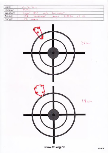

CCI Velocitor 40gn 1435fps CPHP
My first boxes of Velocitor, a very popular ammo according to the gun store where I bought it, and I can see why as it had the best groups of all ammo tested.
This is now my preferred supersonic ammunition for my Ruger 10/22. Wish I had known about it earlier!
The only (fairly major) downside is it is very expensive at NZ$119 per 500 compared to NZ$69 per 500 for CCI Mini-Mag.

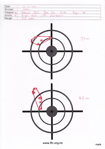

Federal 36gn Bulk CPHP (Blue Box)
Poor performing bulk box load of loose 22 ammunition. Comes in a blue box, sorry I don't have the original packaging.
I'll never buy it again.
Can be had for as little as NZ$49 per brick of 525, but why would you, it really is poorly manufactured cr*p.
Edit: I should elaborate on this statement, projectiles were poorly shaped, some quite loose in brass, and most covered in a yucky in appearance residue.

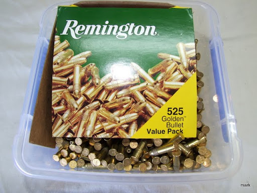

Remington 36gn 1280fps Bulk CPHP (Golden Bullet)
Second best performing bulk box loads of loose 22 ammunition, following Winchester 333.

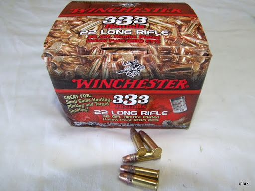

Winchester 333 36gn 1280fps Bulk CPHP
Seems to be the best performing of the bulk box loads of loose 22 ammunition. If it hadn't been for the huge "flyer" on the 4th target it would have averaged a lot better group size. This wasn't shooter as rifle was well sand bagged in all tests.
A box of Winchester 333 rounds is NZ$29. This makes it the cheapest ammo in the test per cartridge.

Naturally the groups of the ultra high velocity CC Velocitor printed higher on the target than all other ammo, and subsonic ammo from Winchester and CCI was 2 inches below that of the supersonic ammo.
What was surprising is that normally ultra-high velocity ammo groups very poorly. The CCI Velocitor did well to group best at such high velocities, but you pay for it at the counter at NZ$119 per brick of 500. At NZ$0.24/round its by far the most expensive ammo tested.

All brands of CCI ammo beat out allcomers for smallest group sizes. While this range report on its own doesn't really have enough groups fired (or ammo types!) to be statistically assertive, but when taken in conjunction with previous range days with various groupings CCI does seem to me to be very accurate ammunition of high quality manufacture. I cannot recall the last time CCI FTE or FTF.
Where accuracy is not quite so important and I need cheap ammo, the Winchester 333 bulk ammo was the best performing bulk ammo, and the cheapest of all ammo tested per cartridge.
