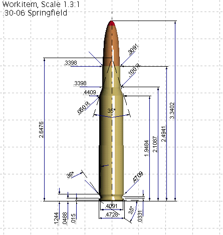

30-06 Springfield
The 30-06 was created after the bad experiences in Cuba in the battles of San Juan Hills. The US army hurriedly elongated the ,7X57 case by another 6mm to 63mm and increased the bullet dia from .284 (7mm) to .308 ins, the result was the 30 spring field. It was finally adopted in the year 1906 by the US Army and hence the name 30-06.
The 30-06 is the most successful battle and hunting cartridge the world has ever known. It gained popularity all over the world in a short time. It continued to rule the battle fields until the last few decades.
It is still within the most popular 5 or 10 cartridges by the sale count all over the world.
It has taken all types of game in all continents of the world, it may be under powered for use against the Brown Bears of North America or the Buffaloe, Rhino,Lion , Leopard and Elephant in the Africas, yet all animals have been taken successfully by experienced hunters using good bullets and knowing when and where too hit. How ever it is niether recommended nor allowed by law to be used against the biggest 4 of the Big Five.
A 24 year old niece of the famous actress Ingrid Bergman , whose name is Astrid Bergman Sucksdorff of Sweden Killed a number of man eating Tigers and Leopards in India in the 1960s and she has given splendid matter of fact accounts in her book " Tiger in Sight " The Rifle she used was a 30-06 Husqvarna made in Sweden. Her book contains large number of photographs and deflates the hair raising stories told by the shikaries of yester year.
The 30-06 is the un disputable king of rifle cartridges.
Since rifles more than a 100 years old are still proudly used by great grand sons of original owners, the factory cartridges are not loaded to full potential to avoid consumer liability in the US.
Therefore the true beneficiaries of this cartridge remain the hand loaders or those who can lay their hands on the Light Magnum 30-06 Ammo by Hornady or the German ammo by RWS, or Norma or Hirtenberger.
The excellent bullets are from 150, 165, 180, 190, 200, 220, and 250gr. The long range performers are the 165 and 180 grains.
The rifling twist of the O'6 is 1 turn in 10 inches, and it stabilises bullets heavier than 150 optimally.
The ammo is available world wide and old military ammo which is cheap is also available for target and fun shooting.
The bullets have high BC and high SD making these useful for big game.
The bullets have very good ranging qualities in the wind.
165 gr bullets can be loaded upto 2900 fps and the 180 to 2800 fps which makes it a very powerful long range round.
It has 125, 130 and 140 grain bullets as well but these shed their velocities in the air due to poor BC and no good for big game hunters so I am not even mentioning these.
There was once a surge of Accelerator bullets ( 1980s) of only 55 grains which had a neoprene sabot around these which was discarded on firing and the bullets could be fired at velocities of up to 4000 Fps but these were accurate only in some rifles and not all, also every time you change the weight or shape or make of bullet you have to re zero your Rifle and this gradually precluded the use of these accelerator rounds as these could be a couple of feet off the point of aim of a rifle zeroed on other regular rounds. I personally like the Spitzer Boat Tailed bullets of 165 and 180 grs in this cal and use Nosler Ballistic tips, or Partitions and Speer 165 grs.
