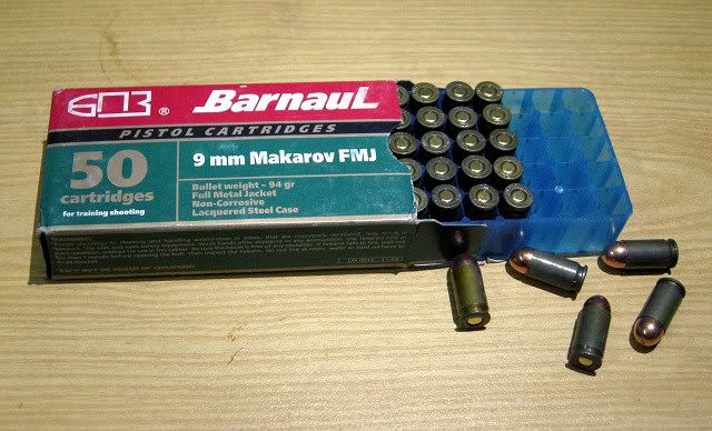

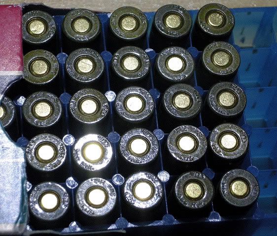

Barnaul 94 grain FMJ
Manufacturer............... Barnaul Cartridge Plant, Russia
Price........................ Rs 50-60 per bullet
Stoppages............... None
Group
- String 1...............1.6 inches (44/50)
- String 2...............3.5 inches (25/50)
- Total...................69/100
Score
- String 1...............46/50
- String 2...............50/50)
- Total...................96/100[/b][/color]
Totat Score...............165/200
Availability……………... Fresh arrival. Available from prominent dealers in big cities.
Comments
- VERY ACCURATE AMMO.
- Recoil is higher than the ordinary Russian ammo but lower than the Federal ammo.
- A very good choice, if the availability remains stable.

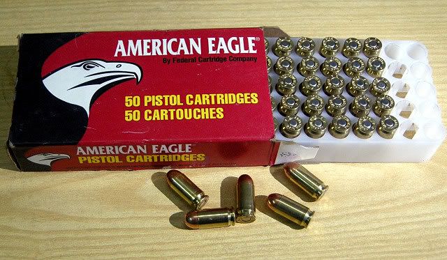

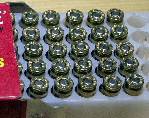

Federal American Eagle grain High Velocity
Manufacturer............... Federal Cartridge Company, USA
Price........................ Rs 50-70 per bullet
Stoppages............... none
Group
- String 1...............2.2 inches (38/50)
- String 2...............1.8 inches (42/50)
- Total...................80/100
Score
- String 1...............49/50
- String 2...............48/50)
- Total...................97/100[/b][/color]
Totat Score...............177/200
Availability…………….. Available with big dealers only.
Comments
- VERY ACCURATE Ammo.
- This ammo performed the best in the tests.
- It however has the strongest recoil of all three which makes the second shot comparatively difficult.

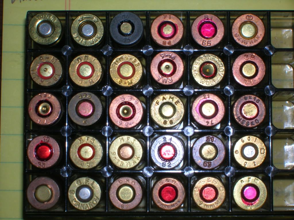

The ammunition with the "10" code is from Bulgaria. It looks like you also had some Chinese "71" cartridges.

OK, here is a short, quick attempt to help with 9mm Makarov ammunition identification. I will include a pic of some of the headstamp variations in my collection, as well as some common shooting ammo. I am envious of your Russian "17" code as I have not had the opportunity to get one of those...yet.
There are many loading variations of the 9mm Makarov cartridge, from at least 14 countries, and seen with brass, aluminum, copper-washed steel, brass-washed steel, laquered steel, and "silver" steel cases.
Here they are identified (left to right, top to bottom):
Speer-US, Starline-US, East Germany, China, China, China
Yugoslavia, Yugo., Yugo., Russia, Russia, USSR,
Russia, USSR, Russia, Peru, Poland, Poland,
Bulgaria, Hungary, Hungary, Hungary, Hungary, Uzbekistan,
France, Italy, Czech, Czech, Czech, Slovakia.
And a few more from Russia, Russia, Russia, Russia, US.
I hope this is helpful. Please post any comments or questions.

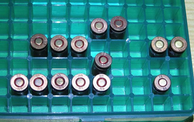

jonnyc's pic of Mak ammo aroused me search around the old cartridges / cases and see what all head stamps I had. I could find following old ammo.
1. 10 00
2. 71 93
3. ?? 50........... were they manufacturing Mak ammo in 50 :o Ist stamp is not readable
4. 38 82
5. 38 83
6. 38 84
7. 38 85
8. 38 87
9. 38 89
Could not find any case with 17 though :(

Very interesting. I think the earliest documented Makarov headstamp is 711 * 49 *, and there is a rumor of a 1947 example. Can you post a pic of the "50" that you have?

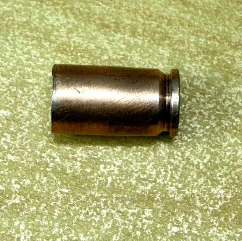

Sorry brother, it got late. This was some old ammo that I fired many years back. There was still one case lying with me which I quoted that day. Now when I wanted to take the pics, I realised I had lost it. Took me few days in searching it in the junk. However, here are the pics.
The lower figure is clearly visible which is 50. The upper figure is not clearly readable. may be 76 but I cant be sure.
side view of the case.
It is berdan primed, as all Russian Makarov ammo. Hope it is of some help. :)

Could it possibly be a "38"? And a bit to the top-left, it almost looks like an "89" in Arabic. Is that possible?
 Post subject: Re: RANGE REPORT > 9x18 MAKAROV AMMO TESTING
Well, examined it with magnifying glass today. I am not sure because the surface in that area has been scrubbed and so are the figures written under it. The right portion looks more like 8 but the left portion does not give an indication of 3. :confusion-questionmarks:

Ah...the "science" of cartridge study and collection can be very frustrating!
My good friend, who is writing and will soon publish THE book on 9mm Makarov pistols and cartridges has asked me more about this case. I will PM you some of the technical questions.
