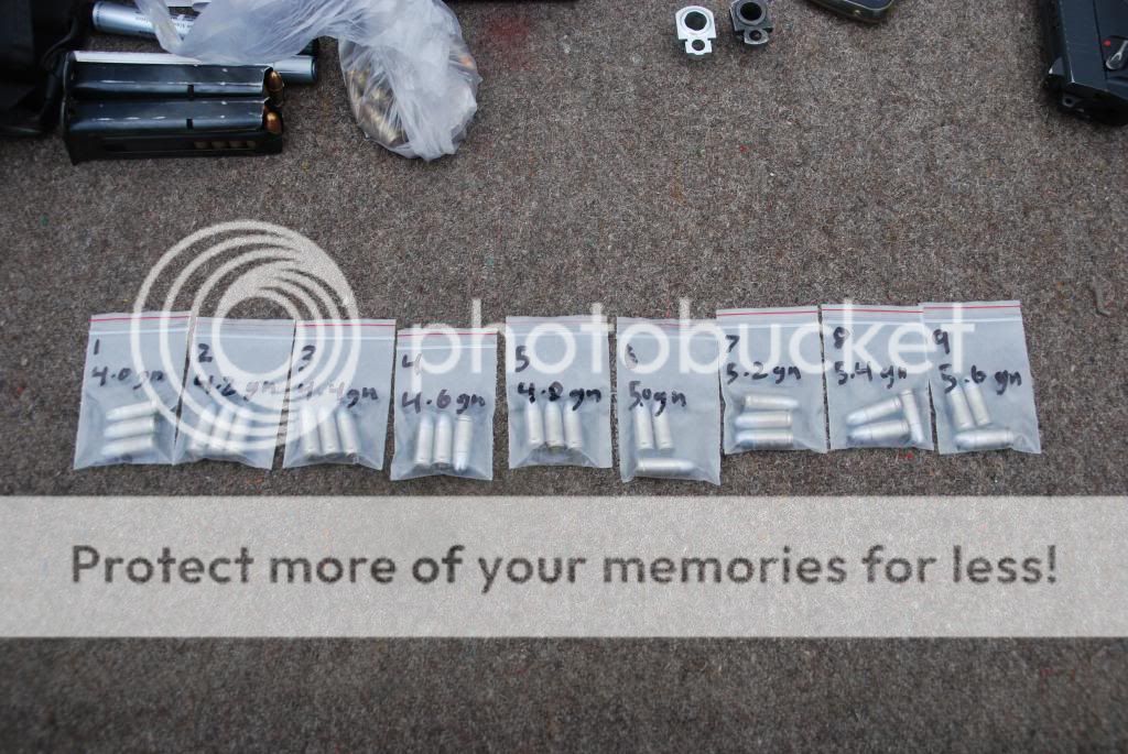

A couple of months back RC sent me a batch of reloaded local ammo to test out. And finally I did it! ;)
What he did was that he took apart the locally loaded ammo, left the primer intact, used his own Cast lead bullets 124gr, made from LEE Mold, and tweaked the same powder used in those rounds by the locals.
By "tweak" I mean trying different amounts of powder. All in all, a total of 9 batches of 3 rounds each (with increments of .2gr) were made to test functionality and other aspects.
It was a great learning to see how to reach at a working load! I will now let the pictures do the talking

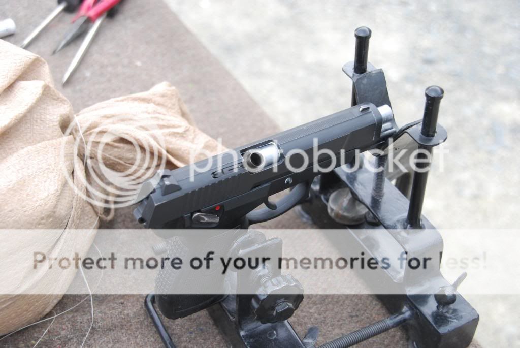

I used my DIY Pistol Handsome Rest for the tests. (setup can be seen below, showing the stove-pipe)
Distance was 20m

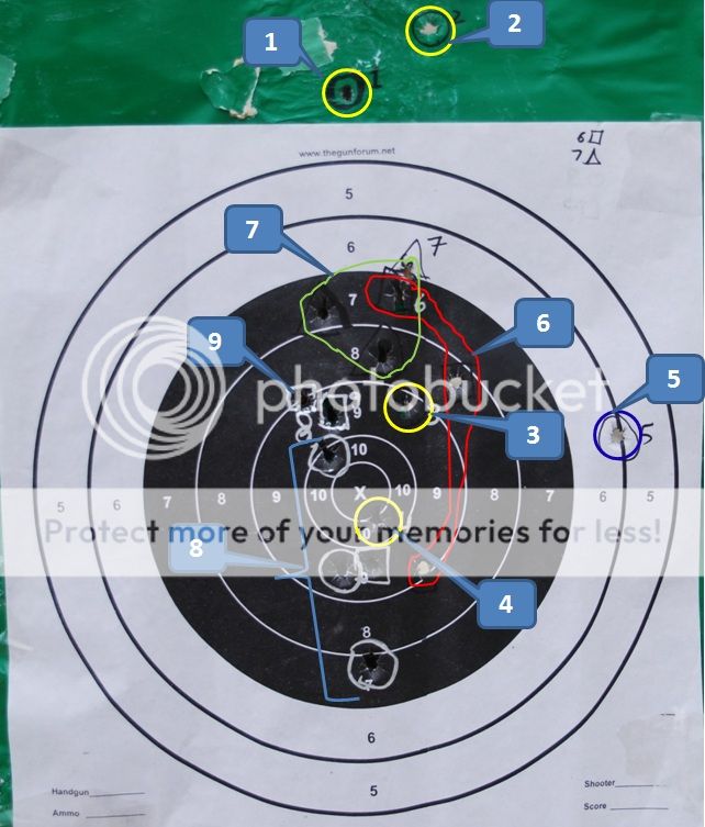

And here are the results
Now the target ...
The Stove pipe ...
Really loved the whole process. Now that we have the bottom line workable load, we can tune to my CF's liking !!! ;)

you fired from the rest. Did you try to fire accurately or testing functionality was the only thing at the back of your mind and you did not bother where the bullets were hitting?
 Post subject: Re: Locally Manufactured 9x19 Luger > Review & Range Report
Thanks sir for the appreciation!
Well I did use to aim the 'rest' in the right direction before firing, but in the first few batches I wasn't even behind the handgun while pulling the trigger! :D

How did the fired primers look , and were there any signs of too much pressure on loads 8 & 9 ?
Were the primers backing out of the case a little bit in loads 1 & 2 ?
Now that the rounds fire, and didn't blow up, it is time if you can, shoot some thru a chronograph to see how fast they are actually going.
Or if that is not possible, do a penetration test to compare the different loads to some factory ammo.
But to focus your testing, IMO load 7 will be your Base line or Minimum load.
But what was the average load in the local ammo when you took it apart , and how consistant were the powder loads ?

One observation brother. Gun functioned properly at 5.2 g. From here on, the next increment in my view should not have been more than 0.1 grain. A 0.4 grain increment from 5.4 to 5.8 is absolutely not advisable. It might have turned out to be safe but the procedure adopted is incorrect and not advisable. I just want to see you guys safe :)
@ RC
Brother KBW has a point, and sorry I missed that detail.
But Now you have a Base load, and since you have already tried the 5.8 and " if " you saw NO signs of primers flattening, then take KBW's advise and work up a few loads in the .1 steps from here on out.
Good luck, and very nice work.

Actually the batches were made in one go because it was not feasible to test one batch and make the other one and i must admit that i got a bit ambitious in the last two batches :) but please note that #9 is 5.6gns and not 5.8. Any how i had given strict instructions to Bro MR that if he felt uncomfortable in any way he must stop the testing and MR has a reputation of being a no nonsense, common sense type of guy.
I will check the primer flattening etc when i get the spent cases back. Also i am going to stick with the standard bullet seating and crimp that is advised by LEE for now. I will experiment when i get a real hold on my reloading skills.

The image with the report has been edited, pointed out by KBW. The difference between each batch was .2gr, not .4gr (between the last two batches), as was mistakenly printed before.
@ KBW:
As RC said the batch were made in one go, and tested later, in another city! ;)
I did inspect the fired cases for signs of over pressure and flattening of the primers (after firing every round). None were there, even in the last batch of 5.6gr. All the fired cases have been delivered to Pindi, where RC will further inspect and post his observations.
@ LAGS:
I did notice the primer a bit out of its pocket in the first batch (RC will confirm, once he inspects them himself), didn't know what to think of it. BTW, why does it come out in "less-than" minimum working loads?!

@ M R & R C
A round that has too little power or that is underloaded will Back out the primer a tiny bit.
This can also be seen if you fire a Primed case with no bullet and powder in it.
So that is normal if your lowest load backed out you primer a bit.
That will tell you what the MINIMUM Powder you can ever use and still get the bullet to exit the barrel.
It is something in your testing that should be noted down just for future refferance.
But this will be listed as Minimum POWDER Load for that Bullet weight and that powder, as it will be different for other powders, and different weight of bullets.
The next noted powder level will be the load theat is the Minimum FUNCTIONING Powder load.
That is the load that functions 98% or better for every round you fire.
That will be your starting level for load and accuracy testing.
The Maximum Powder load is the hardest load to determine.
The easiest way to determine that is by the primers.
As the pressure nears the Maximum, the primer will start to show signs of starting to flatten out either at the radius where the primer cup meets the case, or around the firing pin Dent.
If you see ANY signs that the primer is STARTING to flatten out even a little but, STOP.
Then you are starting to over pressure the case.
Back your load DOWN by a few tenths of a grain until it stops flattening the primers, and that will be your MAXIMUM LOAD for that weight of bullet and that powder and primer.
