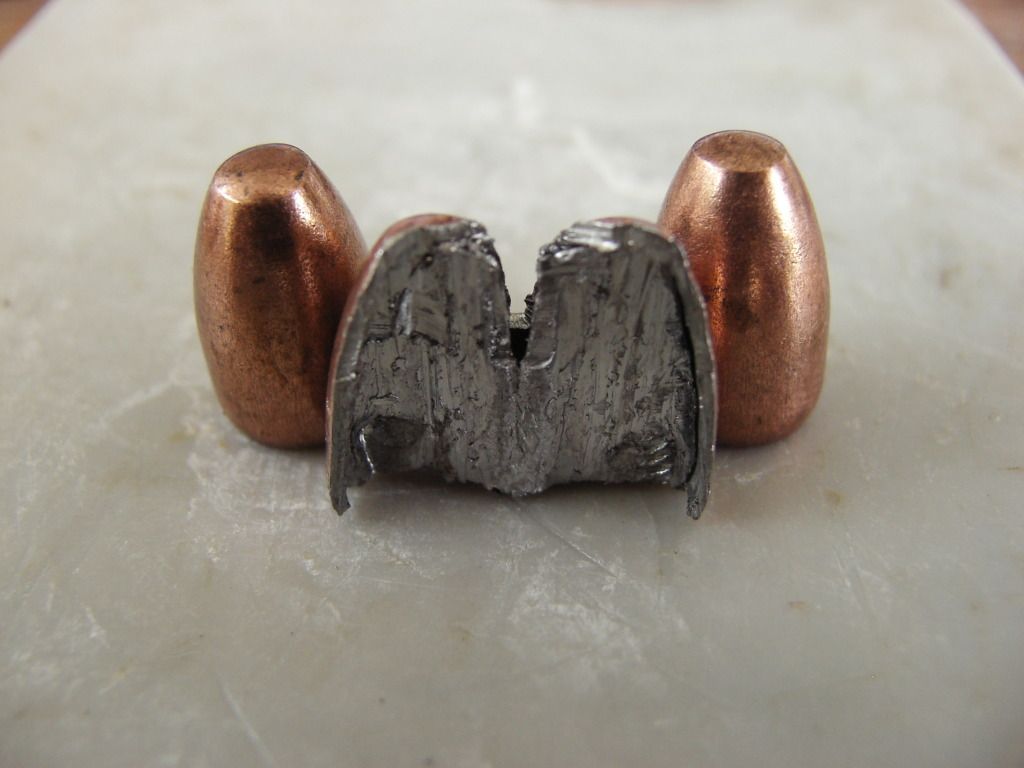

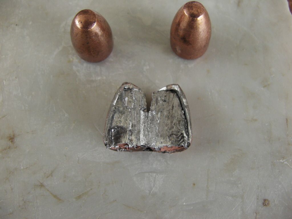

To further increase the knowledge base of this thread, here are some pictures of a disected local bullet.
Notice the thick jacket of this bullet. It is .6mm to be exact.

 Post subject: Re: Locally Manufactured 9x19 Luger > Review & Range Report
Excellent input RC :text-bravo:
.6 mm is a very thick jacket. I was just wondering if they make a proper .355 bullet, will a .6 mm steel jacket not wear out the barrel earlier than normal?
Why are they making such a thick jacket?

The thickness of the JACKET, will have Nothing to do with Barrel Wear.
The metal it is made of will.
If it is copper, it will not WEAR the Barrel.
If it is Steel Jacket, it will wear the barrel. as it is the same hardness as the barrels steel.
The Jacket also has to be thick enough, that the rifling does not cut or groove all the way thru the jacket, and expose the core metal, if it is something hard like steel.
I have shot solid Copper, Lead, Aluminum and Brass bullets, with no signs of wear.
But the metal still has to be versions of these metals that is not Hardened, so the rifling can cut into the bullet as it goes thru the barrel.
Also.
Look at these bullets.
The sides are not very straight.
The bullet is more of a pointed Elongated Ball.
It is a cone shape on the front, then it tapers off to fit in the case.
Then there is a slight Boat tail or bevel at the base.
This design does not leave much BEARING surface to ride on the barrel, and stabilize the bullet going down the barrel.
IMO, this will Never be a consistant accurate bullet

While gun barrels are usually made out of hardened/tool/ordnance steel, bullet jackets are usually made out of softer mild steel, and should not create any undue wear in a barrel. I guess if you shoot 50,000 rounds of high-velocity a year, and never clean the barrel, you might have a problem ;)

In my opinion, the jacket material seemed very hard as i slid a screw driver in the slot that i made to open the bullet up. It took considerable force to get it open. I would not like to use these bullets in any case.

If these guys made a proper sized bullet, i can only envision many pistols with smooth bore barrels :mrgreen: and every gunsmith having quite a few blown up pistols and parts like triggers, hammers springs etc available in abundance. :whistle:

I don't think darra guys are using some very hard kind of steel for making bullet jackets. These bullet look like made of cast iron sheets which can not be harder than the barrel steel. Yes, as jonnyc say, if we fire thousands of rounds of this ammo, it might effect the rifling.
