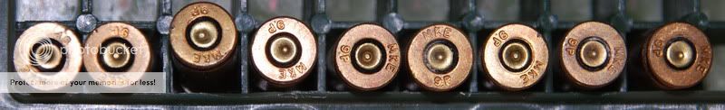

Also, I tried the same ammo with a different handgun also, a Sarsilmaz B6, but the result was the same. Fired 40 more rounds from two different handguns and got 8 more duds! So my initial report of 20% failure rate remains correct after a total of 45 rounds fired!
These are all the duds!
The left most bullet is the previous one, shown in above post. (It was tried 3 times in CF98 after that!)

Hence proved : Faulty ammo

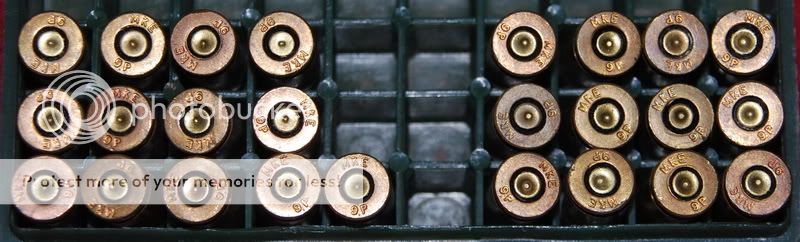

Latest Update:
I did try the rest of the rounds, when a friend came by with his Glock17!
While the failure rate of this ammo in my CF98 was around 20%, it was more than 50% in the Glock17! :o
These are all duds, the left ones (mostly) were shot (tried, that is) in the Glock17 and the left ones by the CF98.
Total 25 failures out of 100!
If you closely look at the carts tried on a Glock17, the firing pin strike seems very shallow or light! Is it due to the striker fire tech? do they strike lightly?
Because if that is the case, a Glock17 claiming to be an eat-it-all, is not so true! Specially in the case of old hard primer mil ammo! :think:
The Chinese CF98 and Turkish Sarsilmaz performed comparatively well in relation to the Glock17! :D
Comments?!?!
