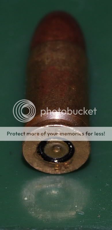

The left one is a fired case, the right miss-fired!! Note the firing pin impression!!
The miss-fired cartridge

Did you try to put the FTF back in your gun ans try it a second time ?
The primer strike looks strong enough, but it could just be a bad primer.
Pull rounds like this apart and do some investigation, and save the brass, bullet and powder for future reloading if it is a brass case.

Pin strike is deep and well defined. I dont think firing it again would be of any use. Accuracy is quite decent.

Those two firing pin strikes appear very different to me. Ammunition, especially military, is manufactured to be safe an not too sensitive. For whatever reason, I think you had a light strike and that the round will fire on a second try.
 Post subject: Re: 9mm Ammo Report - 'MKE' Turkish
JonnyC, with all due respect, those two firing pin strikes look very different because one got fired and one didn't!
The impression on the fired case (left) looks prominent because the back pressure of the case pushed out the dent, from around the pin strike area. The un-fired case has just the pin impression, and whole of the primer is bent inwards, hence the actual pin impression seems light.

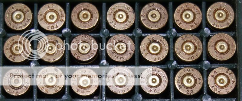

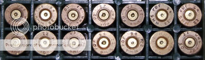

Now please have a look at the pic below, both the carts have fired (from different handguns), although the impression on left seems very light!
The left one was fired from Sarsilmaz B6 and the right from the CF98. The difference is in their firing pin systems! ;)

I think there are lot many variables, like LAGS said. Its not just the ammo, its the handguns as well as is clear from the pic above

@ MR
The two recent pictures of the casings clearly shows the one on the left shows signs of higher chamber pressure.
It is no where near dangerous levels , but being flattened out more, it shows there was more force against the back of the case.
This could be due to many factors, and can not be evaluated just by two casings.
But if you fired 20 rounds from each and they looked the same, I would venture to say, one had a tighter or rougher barrel than the other.
The striker method would have little to do with pressure signes, or flattening of the primer.
This is a very good example of why the same ammo will work differently in two different guns.
Maybe, and maybe not. The last picture is of rounds fired with different handguns, agreed ... but the topic rounds were fired from the same handgun. The fourth round miss-fired, and it shot two more after that (without any field stripping or cleaning)

LAGS wrote:
@ MR
In my opinion the flattened primer might not be due to higher chamber pressure but may be due to firing pin design.
The Salsilmaz has an "Inertial Firing Pin", meaning that its much shorter than the total length between the slide rear (from where it is visible) and the bolt face.
Upon firing, the hammer strikes the pin, which uses Inertia and Kinetic energy gained from the hammer to strike the primer! As soon as it strikes the primer, it goes out of the way before the slide starts to move back. The pressure in the chamber then flattens the primer impression! But that's just my opinion ;)
It just maybe due to lighter firing pin spring! (which the inertia type pins have)
On the other hand, the CF98 has a full length firing pin (it is visible from the hole in the bolt, when pressed from hammer side), and remains in contact with the primer till the slide starts to move back!
I will however, try the MKE ammo again in both these guns, before reaching to any conclusion!
