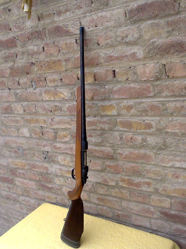

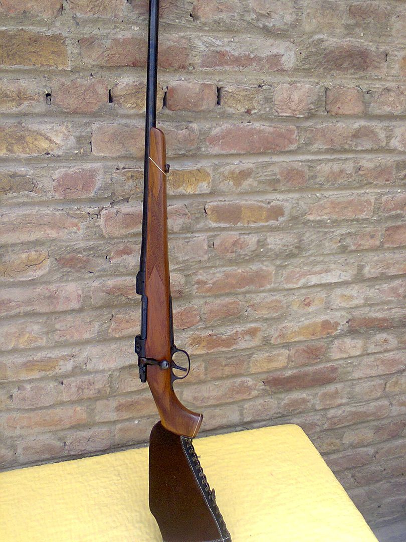

I always wished to have a bolt action hunting rifle chambered in 308/7.62x51 being a round of my choice as this round possess better ballistics qualities. But the prices of bolt action rifles chambered in 7.62x51/308 are insanely high in this part of world. Some friends came up with the suggestion of re-barreling a rifle in to 308. The idea seemed workable but since a 308 round generates an enormous chamber pressure thus it was a genuine matter of concern to select a rifle and design to withstand the gigantic pressure of 308 round . Finally , with the help and advice of a very knowledgeable friend , located overseas , having a practical experience of gunsmithing ( One and only LAGS , our teacher) , the design of mauser 98 and caliber of 7x57 was chosen.
I had 2 rifles in 7x57 , a parker hale and a BRNO ZKK600, I always love BRNOs and selected the BRNO for rebarreling, though my friend opined that the bolt of a Parker Hale is nearer to the original mauser 98 bolt design. The integrated dovetail to mount scope was another plus in BRNO so I proceeded with it. My teacher also gave a nod and told me that the action of ZKK 600 was the standard action that BRNO used in many calibers including 30-06.
THE BARREL
The barrel of 308/7.62x51 was hardest thing to come by. Another friend told me availability of machine gun barrels, coming from Afghanistan (presumably supplied by NATO to Afghan Government Army who sale them subsequently) in the area bordering with Afghanistan. The area was extremely volatile and unstable, yet my craze for the gun drove me there. I remained there for several days and heard something horrible every day. Once a friend came to see me and on his return , his car was snatched just minutes after he left the place i was staying. Those circumstances were horrifying but finally I got the job done and the task of re-barreling was accomplished. Here is the result

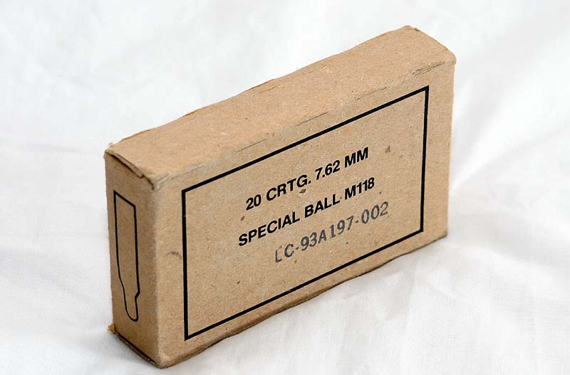

There are two type of LC NATO Ammo in our market, with the following two stampings:
1) LC + 07 (with 07 being year of production and the + is the "Nato cross")
2) LC LR 07
LC M118 - Packing and Stamping:
Bullet weight ranges from 172-175gr.
LC M118 Long Range - Packing and Stamping:
In the LR, you get a 175gr Sierra Match King bullet as well as a different powder from the M118, less sensitive to temperature variations. The Ammo is loaded at Federal Cartridge Company and Federal has designed a new match case based on their Gold Medal Match casesfor this LR ammo. Federal also uses their Gold Medal Match primer for this load.
Till about a couple of months back (last time i checked), the M118 was still available in Peshawar and beyond for Rs. 50 a pop. The M118 LR, although a little difficult to find, is generally sold in Karachi between Rs. 100 to 120, at least that was the rate I got for a few hundred of these in Dec/Jan.
Try to get Lake City's LR ammo. :)
