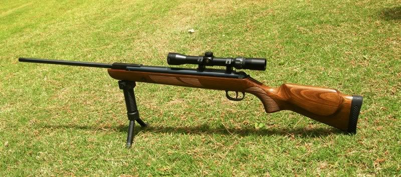

RWS air rifles, specially the deluxe models like the one in pic below, are a real joy to have. Excellent craftsmanship and reliable service for decades. Gamo doesn't fall in that category though its a reasonably good air rifle in its price range. Try to look for a deluxe model as standard model do not have that classy finish though they are good enough.
This air rifle is more beautiful than it looks in the pics.
