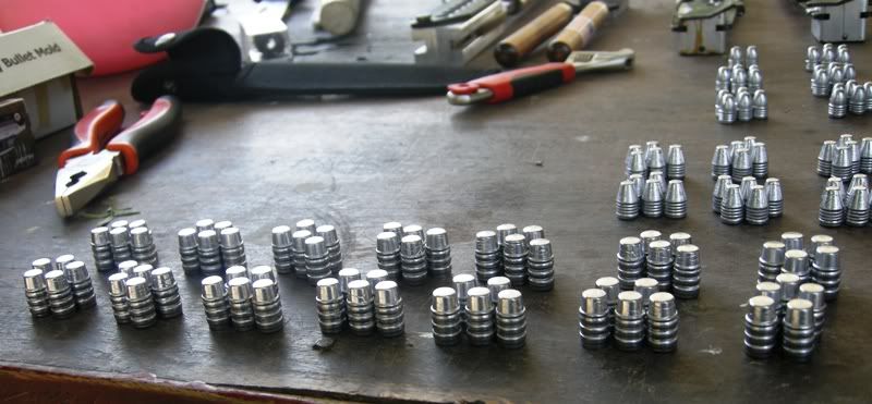

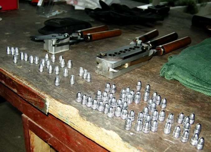

What are cast lead bullets ? that is what is confusing me.
Cast lead bullets are bullets casted with lead using a mould. They do not have a jacket over the bullet as in case of FMJ and JHP rounds. Normally done by reloaders. Here are some of them......
.356 round nose and flat nose bullets in 124 grain.
.358 semi wadcutter bullets, 158 grain.
Tumble lubed 148 grain .358 wadcutter bullets.
Since lead is much softer than copper (used in jackets of FMJ bullets), lead bullets tend to cause more fouling in the barrel called "leading". That is why it needs a better and quicker cleaning when using cast lead bullets (which are mostly reloaded rounds).
Hope it helps.
