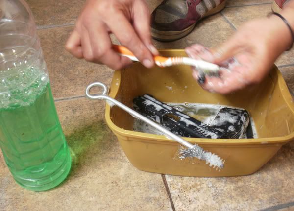

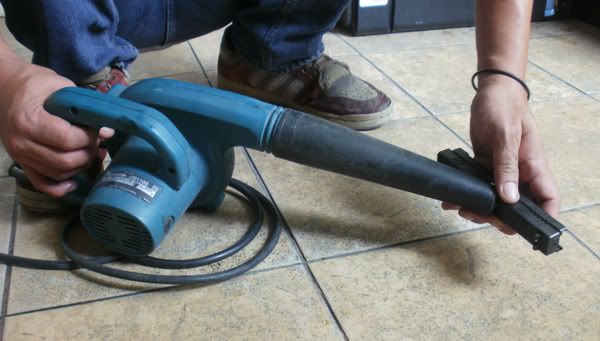

I wash my gun using dishwashing soap and water. Do this ONLY if you have a power blower or air compressor. Otherwise, you cannot dry the water out.
Here with my handy steel wool (pot scrubber) bore brush
Very effective, cheap and fragrant!

delacruz12002 sir thanks for the share.
Do you use and solvent / cleaner other than soap ?
I am sure you know what you are doing but is it safe to dip whole gun in soap / water in the long run ?
 Post subject: Re: How to clean a Pistol after shooting session?
@ Shariq
Cleaning with soap and water will get off what it can , including the OIL.
Black powder guns were cleaned with soap and water, because it neutralized the Salts in the Corrosive powder.
This is also a good way to clean your barrel after firing corrosive primed ammo.
BUT ...... the Metal must be completly dried afterwerds, AND Oiled, or the parts will rust.
Joined: Thu Feb 03, 2011 5:01 am
Posts: 60
Location: Philippines
Sir Lags, you are a master of DIY gun maintenance. There are indeed a thousand and one alternatives to gun wares sold at gunstores.
Sir Shariq, I use only soap and water, no solvents. The purpose of the blower/pressurized air is to drive out moist from all corners of the gun, to avoid rust. Oil afterwards.
May I also say that kerosene or gasoline cleans the gun better than soap & water. However, it leaves the gun smelling like an engine, so this is just a preference.
@ delacruz
Check out the new thread under reloading . " Thinking outside the Box "
You might get some ideas for blowing off your guns.
