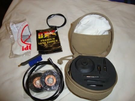

I bought a nato cleaning kit that has flexible wires for both handguns and rifles/shotguns.
An extension Can be attached to the wire on which the patch can be fixed.
Very useful.

The round thing is an attachment for 40mm grenade launchers
Im thinking of making a LUTOO from it

@Muhammad m
muhammad m wrote:
Brother this is a normal cleaning kit. Does it contain a bore snake also?
And may I also request you to write Muhammad with capital M in your user ID.

No it does not have a bore snake
But the round brush attachment is made from very hard wires. Cleans real good.
