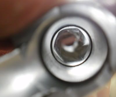

Intersting topic. A personal experience:
SA was here during summer and generously handed me a fluid bottle of Hoppes No. 9 copper solvent. Had never used solvents before. I thought to try it out on my special rifle, which is always "lush push", cleaned, oiled, dusted off, ready for the "go" signal anytime! ;) :lol:
Heck, even this highly "clean" rifle barrel wasn't exactly as clean as I really had expected it to be! The patches kept coming out green, one by one, and I think I gave up after full 10 patches or so, still green! :o :angry-fire:
I left it there, since I had the impression, that this problem is not going to get solved without some brass brush, which I didn't have at that time. I'll give it a try now, since my Otis Kit does have a brass 7.62 brush.
And trust me that rifle barrel just shines like anything you could think of.
I was wondering in fact, that loaded with this solvent and a few white patches, no dealer could ever sell you an old weapon in the name of a new! :twisted: :lol:

My experience with the Hoppes # 9 solvent has also been similar. The shine in the pistol barrel is indeed like anything after a few patches of this solvent.
