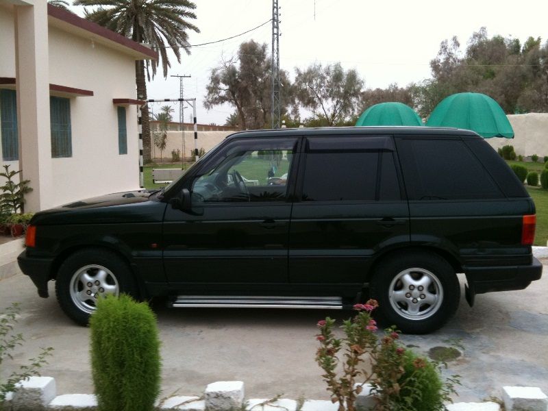

1999 Range Rover HSE (4.6L V8, 4 speed auto transmission, 4wd)
This was my late father's car, which had started to suffer from some neglect after his death. Other than restore it to pristine condition, there were no modifications that were carried out, or even contemplated on this vehicle. Primarily, a family vehicle; this RR is a supremely capable off road rig nevertheless. But somehow, I'll never really "push" it that way...for obvious sentimental reasons.

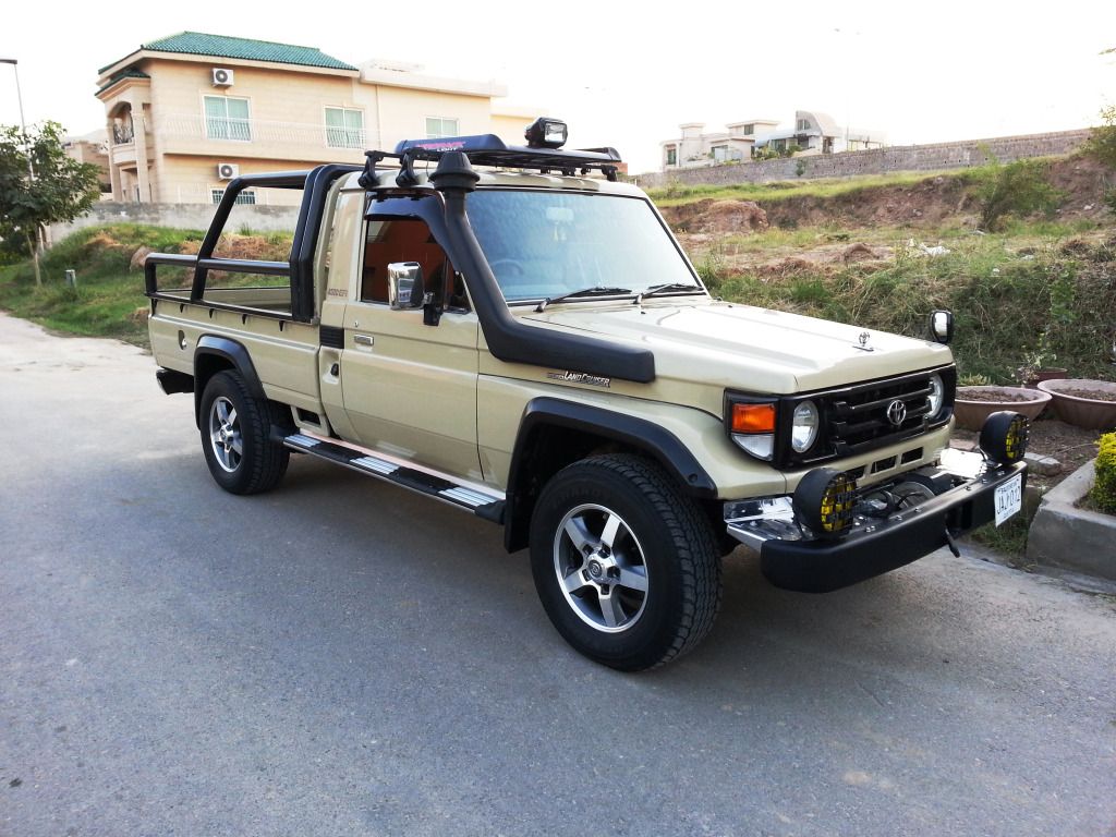

2003 Toyota FZJ79 Pickup (4.5L I6, 5 forward gears, 4wd)
This is an obvious hunting rig. Most of the modifications with this vehicle pertain to body work. The winch, the fender flares, the roll cage, the rear bench seats, the foglights, and the GoLight (mounted on the roof) are all a means to the end of "the hunt". This is very much an all-terrain vehicle, which is equally at home in mud, sand, gravel, or rock. With front and rear differential locks, this ride may look like a mere "loader", but is actually a very capable off road rig.

Sir the last jeep in the write up, the toyota, on the left i notice a snorkel and in the rear a huge exhaust. Is that really an exhaust or just put there for cosmetic reason? That is one big exhaust.

That is indeed an exhaust that you see. Whilst deciding the underbelly "ergonomics" of the Toyota, a normal "below the waist" silencer would have reduced it's clearance/ride height, with the result that we opted for an upright "chimney" exhaust instead. In tandem with the snorkel, this sort of a setup allows greater water fording ability. Plus, it looks nice with the overall "flavour" of the vehicle.

Thanx alot sir. But again, is installing a snorkel, beneficial in the overall performance of the car, other than providing safety against water?
