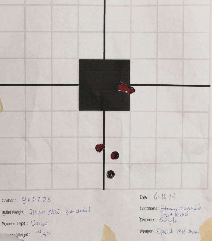

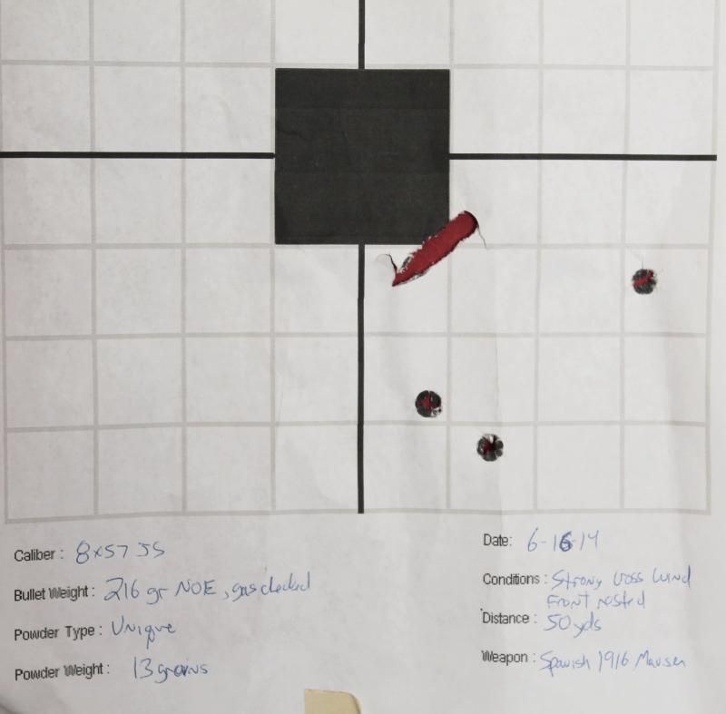

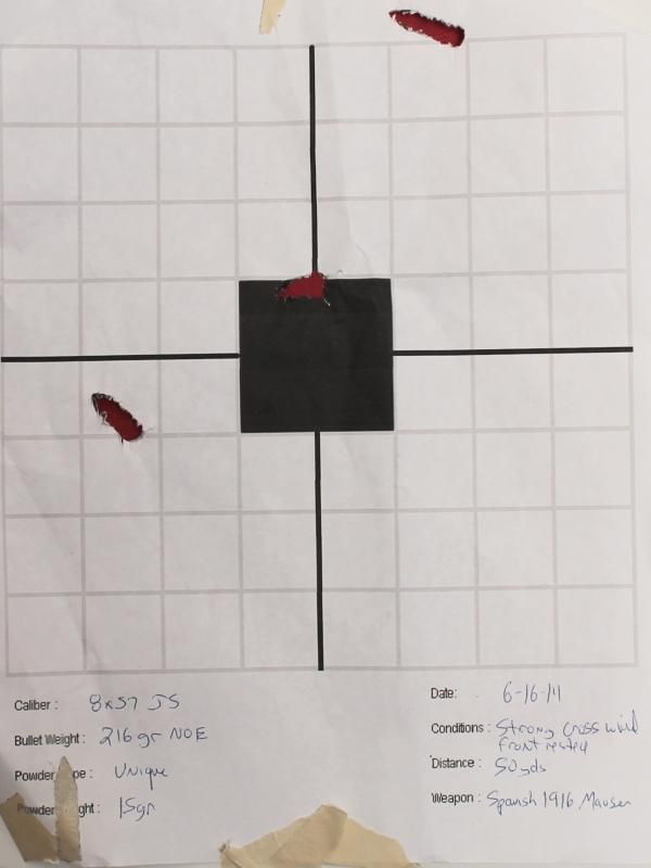

The other powder my friend had sent me to try with this bullet was Unique, so using the Lyman data, here we go....and it went downhill from the first round.

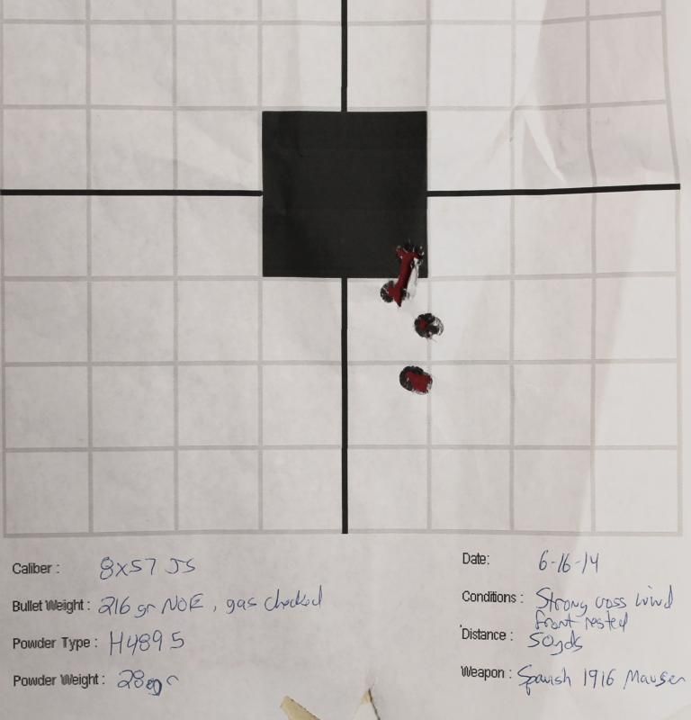

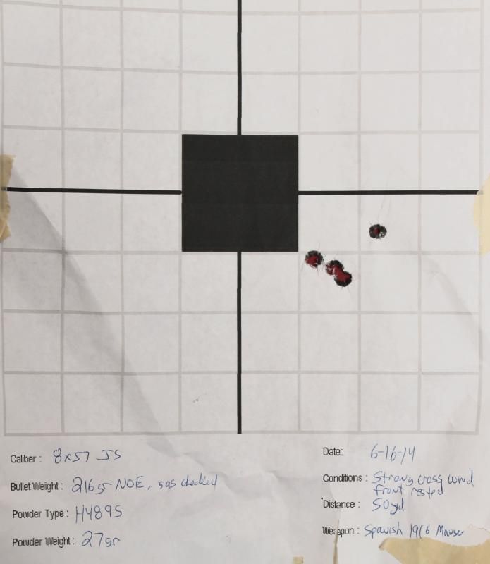

^ That one is just...wow. Note the tape covered bullet shaped hole lower left...that belongs to this group. At this point I was ready to throw in the towel, BUT....BUT I had decided to use up the last 16 bullets he'd given me with a traditional rifle powder that I had a little left of, H4895. So, I reset the target stand, added rocks to the pile, aimed and fired...
I heard an angelic choir singing Queen's "We Are The Champions"....I was ready to give up on this combo, but it simply looks like this bullet HATES fast pistol powders, and would FAR prefer a slow rifle powder. I need to get some more of them and some more H4895.
